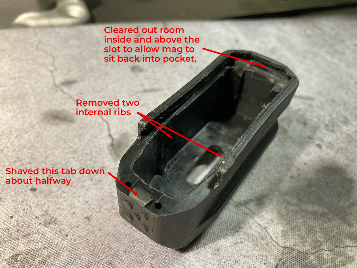

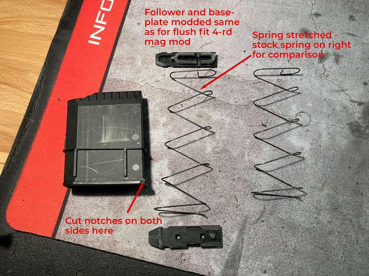

For mods, here is what I did to the extension:
[Image: minimagmodbase.jpg]
I made a little relief cut at the back of the mag body's lower shelf, and I basically followed the flush-fit 4 round mag instructions for the follower and baseplate. I also stretched the spring a bit to alleviate the follower nose-diving.

And here is a short, shaky video showing 9 round cycling through the rifle with no problems:
