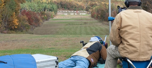

Course of fire typically is 20 rounds (+sighters) at 600 yards, fired one shot at a time. This is a structured event where rounds are fired from the prone position with competitors all abreast in a timed course, of 22 shots (2 of which are sighters), fired in 22 minutes. And each shot into the paper target 600 yards away is marked (note 1st picture); so you can see where you hit every shot, and adjust as you go.
Each 600 yard target frame is about 3' across.
[Image: images?q=tbn%3AANd9GcSjoR1utdLBXvE71bcGx...3bzJy5Yuua]
Here's a generic internet photo of what it really looks like, 600 yards away:
[Image: ExCf_sgcUQpXqQxeea1IgBHCmDLF4tTowdcOyx4C...7rAWT_ablX]

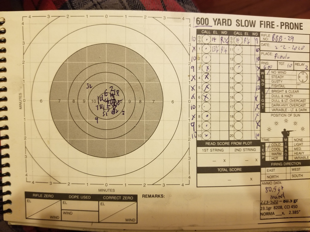

I took my standard National Match 5.56 20" AR15 (Service Rifle category gun); which is fired from the prone position using a sling for support, and a 4X scope. For comparison; here's how the Service Rifle shot:
Record sheet from 5.56 AR15 at 600 yards - 20 rounds fired + 2 sighters.
80.5gr Berger @ 2770 FPS, 0.82 seconds flight time.
[Image: 20200203-221025-1.jpg]
Which of the 20 rounds fired, came out to a score of 198-11x. This is good. Note the grid lines are in MOA; which is to say each line represents 6 inches @ 600 yards. (the S2 in the 9 ring upper left, is the second sighter shot)
