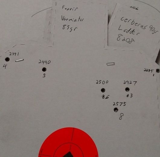

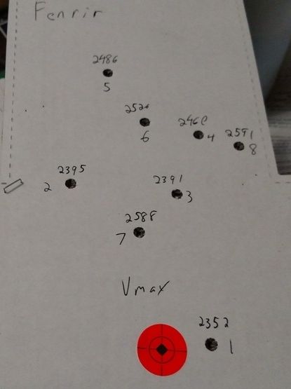

                        I finally got a chance to run a ladder with a couple of these last monday.
                        11.5" Lilja Nitrided Barrel Manson Reamer Grendel Chamber 8" twist
                        Hornady Brass
                        CCI 450
                        Vmax
                        OAL 1.678 COL 2.234 JTL 0.020
                        8208 XBR gr/fps
                        V 29.2 2352.0
                        V 29.5 2395.0
                        V 29.8 2391.0
                        V 30.1 2460.0
                        VC 30.4 2486.0
                        VC 30.7 2526.0
                        VC 31.0 2588.0
                        VC 31.3 2591.0
                        V = Vibratory Settled
                        C = Compressed Load
                        Sierra 85gr Varminteer
                        I had some problems with these. They kept jamming into my lands until the jamming forced the bullet significantly deeper in the case allowing them to feed properly. What length are y'all loading these at?
                        Originally
                        OAL 1.735 COL 2.185 JTL 0.020
                        I don't know what length they were when they feed and shot.
                        8208 XBR gr/fps
                        V 29.0 2299.0
                        V 29.3 2342.0
                        V 29.6 2417.0
                        V 29.9 2391.0
                        V 30.2 2440.0
                        V 30.5 2500.0
                        VC 30.8 2506.0
                        VC 31.1 2575.0
