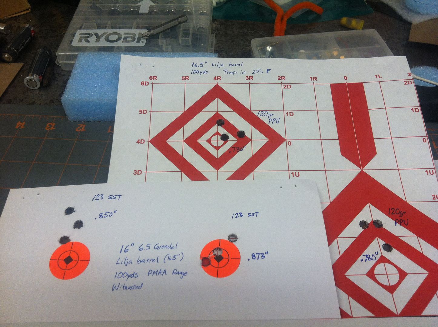

        Wolf doesn't make anything. They are an importer. They have been importing the 120gr PPU in the Wolf Gold line for years now. If you look at the headstamps on the cases, they both say PPU, both are a 120gr BTHP, both made by the same company in the same place (PPU).
        Here are 4 consecutive groups I shot yesterday, first groups out of this lightweight 16.5" Lilja barrel at 100yds:
        Here's a group I shot just messing around getting readings over the chrono with an 18" Lilja I built for another forum member, using the blue box 120gr PPU:
