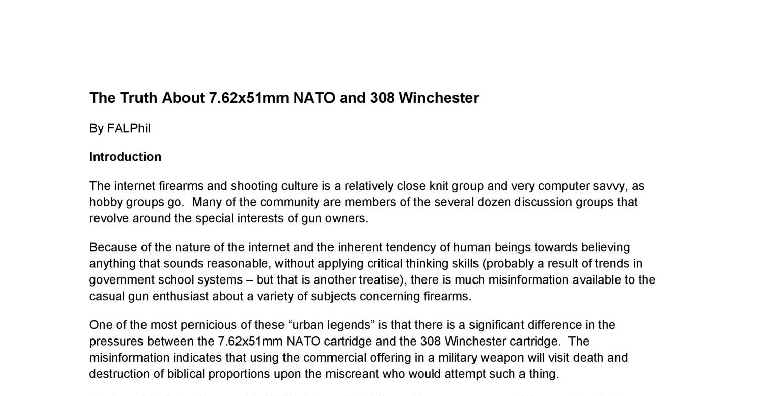

                  The difference is in the pressure testing devices and how pressures are determined.
                  CIP places their pressure transducer further forward than SAAMI, as a result CIP (NATO) rounds will read higher pressure than SAAMI tested rounds.
                  Testing a CIP round and a SAAMI round in the same test barrel either CIP or SAAMI will result in identical pressures.

                      Under SAAMI proof test procedures, for bottlenecked cases the center of the transducer is located .175"
                      behind the shoulder of the case for large diameter (.250") transducers and .150" for small diameter
                      (.194") transducers. For straight cases the center of the transducer is located one-half of the transducer
                      diameter plus .005" behind the base of the seated bullet. Small transducers are used when the case
                      diameter at the point of measurement is less than .35".
                      Under C.I.P. proof test standards a drilled case is used and the piezo measuring device (transducer) will
                      be positioned at a distance of 25 mm from the breech face when the length of the cartridge case permits
                      that, including limits. When the length of the cartridge case is to short, pressure measurement will take
                      place at a cartridge specific defined shorter distance from the breech face depending on the dimensions
                      of the case.
                      The difference in the location of the pressure measurement gives different results than the C.I.P.
                      standard.
