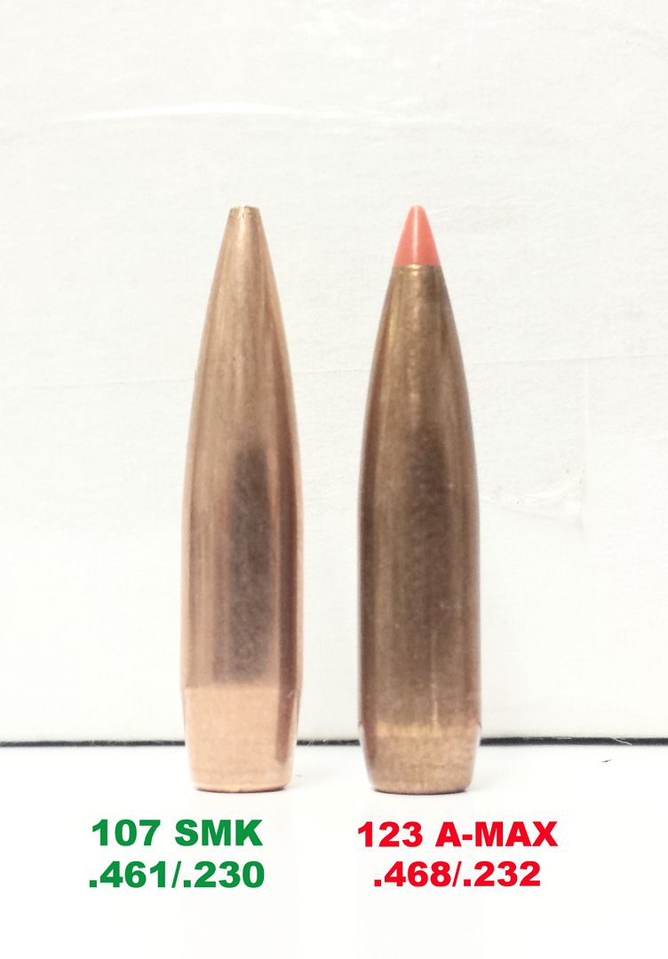

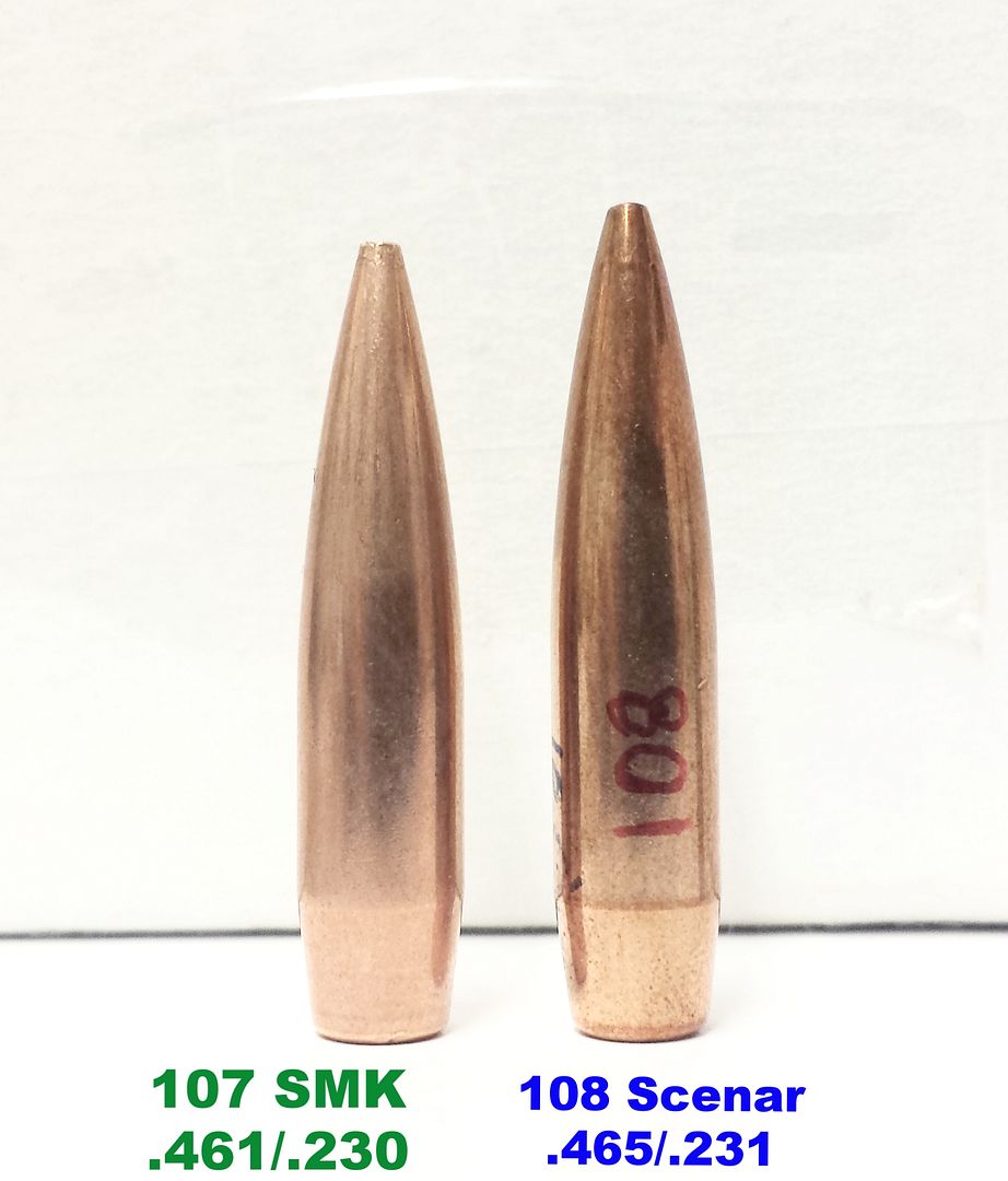

    No, you're on the right track when comparing to the Hornady 123gr stuff, but the 123gr SMK and 123gr Scenar have much higher BCs than the 123gr SST or ELD-M.
    If you put a 107gr SMK next to a 123gr AMAX or ELD-M, it's a very aerodynamic bullet with a significantly longer boat tail. The Litz BC on the 107gr SMK is .461/.230, and .468 for the 123gr AMAX.
    You can get the 107gr SMK going much faster than any of the 120-123gr bullets, so hit probability is higher than a 120 or 123gr with the same BC, because wind drift will be less, as will trajectory and ToF. Recoil and sight recovery are noticeably better for me as well, so I'm leaning more to the 107gr as a go-to bullet that I need to shoot more.

                @ LRRP - thanks, that is a really solid info graphic, much appreciated.

                    • 9035
                    I'll have to shoot the 107gr SMK at 1000yds and see what it does from 2625fps mv.
                    That boat tail on it is way long for it to have such a low BC really, especially when you look at it next to the 123gr AMAX and still use the Litz BCs.
                    The Litz BC is what I'm looking at, which is usually averaged over the different flight regimes.

                      Tell me about it! I have 500 of the 107 SMKs I purchased specifically for my Grendel.. these things are just as long and more sleek than the 123 AMAX for sure.. and as I mentioned we only went our to 810 yards.. maybe going to 1k or better they will truly shine..
                      .406 even felt low to us considering the 100gr eld-m is a .385 and it's nowhere near as long and sleek as the 107 SMK.
