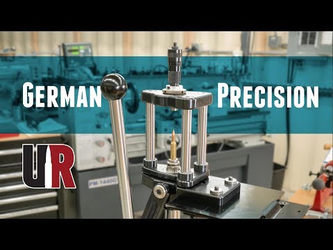

                There is a press that is built to tighter tolerances than the Forrester but at $950 Euros plus shipping and customs fees from Germany price no thanks and they do make one that fits the 50.

                  I considered buying a Prazipress but it lacks the quick change feature. All reviews out there basically say it's not better than the CoAx. I went through the entire purchasing process and stopped when they wouldn't remove VAT from the bill. It looks nice but nah, too much trouble.

                    I looked at those too, that is as far as it is going to go.
