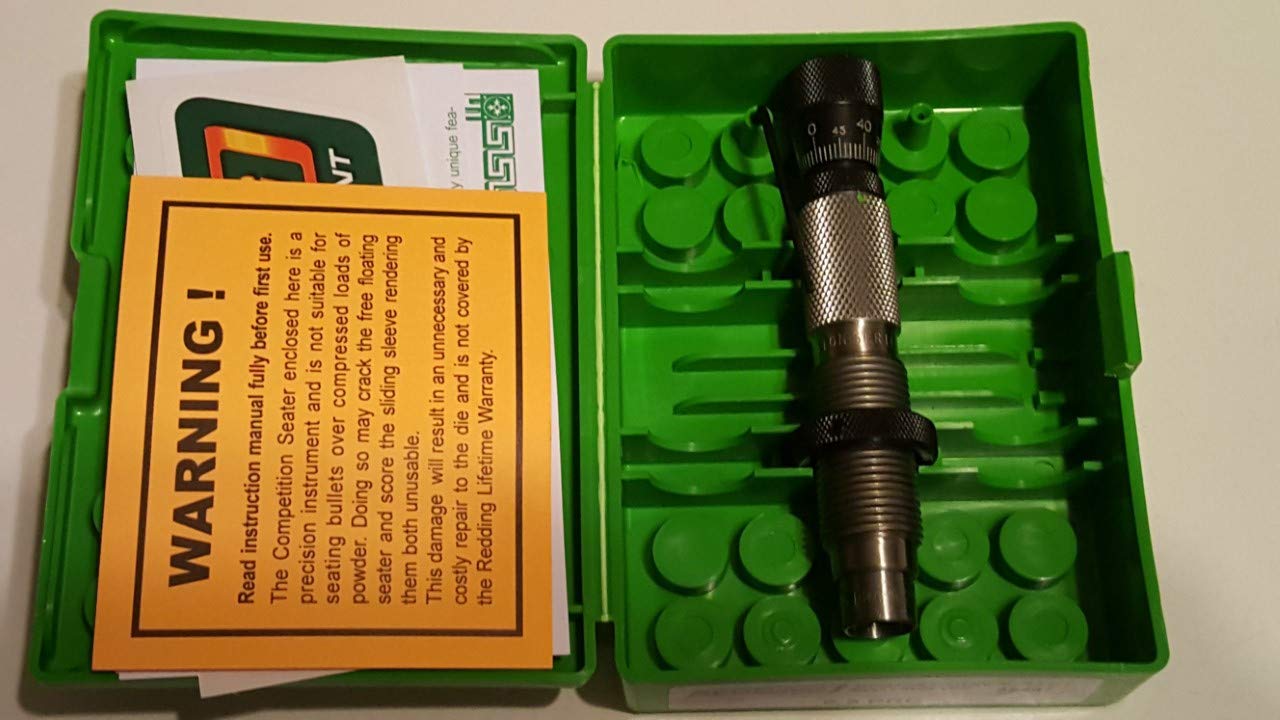

            I wouldn't advise a Redding seating die.
            Read that warning label. They can't figure out how to make a seating die stand up to compressed loads.
            Hornady can do it all day. And has a nice sliding sleeve for controlled accurate bullet alignment, and to help make bullet insertion and getting your hand out of the way an easier and more pleasant experience.
            I've run Hornady and Redding resize dies to the point they needed to be polished. Hornady did it for free, no-questions-asked and payed the shipping for the return. Redding made me pay. Don't get me wrong, Redding makes a good sizing die - I actually like their bushing sizer better than Hornadys sizer. But I would stay away from their weak no-compressed-loads seating die.

              I had forgotten about ?compressed loads voids the warranty?. Another reason to go Forster.

                What he ^ said. I have the Forster sizing and Micrometer die. No warnings about compressed loads voiding warranty.
