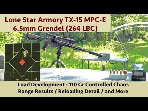

    Double Naught Spy let me have a go with the Lone Star Armory (LSA) 264 LBC TX-15 rifle. I threw on my suppressor and Leupold 8.5-25x target scope and hit the range.
    Velocity could be better but it is one long bullet so powder capacity is an issue.
    I will be joining DNS this upcoming week to try and deposit some of these into Texas Feral Hogs.
    Accuracy was PHENOMENAL....

      I have really good success with that bullet and xbr 8208.

        Good video. I enjoyed it. That was the first time I have seen one of those presses. I have only used my RCBS.

            I was thinking about doing the same. I contacted Lehigh and they suggested, based on their test, to start at 26gr and work up to 28.5gr. Where did you start and finish your work-up?
