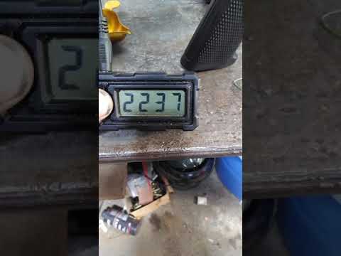

                got to finally test those lehigh defense 110 solids , first 5 loaded at 29g of ppv went 2730 fps , second 5 at 29.3 went 2710 , left side of target is the 29.3 group , on shot#4 my dot fell off and i lost my point of aim for shot #5 . lil stumped on the speed loss but im going to try 5 more just to be sure at 29.5

                  shot 5 more today
                  high
                  low
                  sd
                  es
                  @29.3g

                      retesting today with mag primers

                        mag primer testing
                        i need to continue working up im basing my loads of lehighs data which lists a max charge of 29g of tac , well i know from all my other load data that ppv runs about 1-1.5g more for max on average over tac , unfortunatly i think im done doing any more testing till i get back from vacation in February, i still got to much crap to do before i leave this week i dont think ill have time to do any more shooting
                        my gut feeling is telline me i should see damn near 2900fps out of the 28inch gren with theese if lehighs data is correct sine they claim 25xx out of a 16 inch barrel with tac
