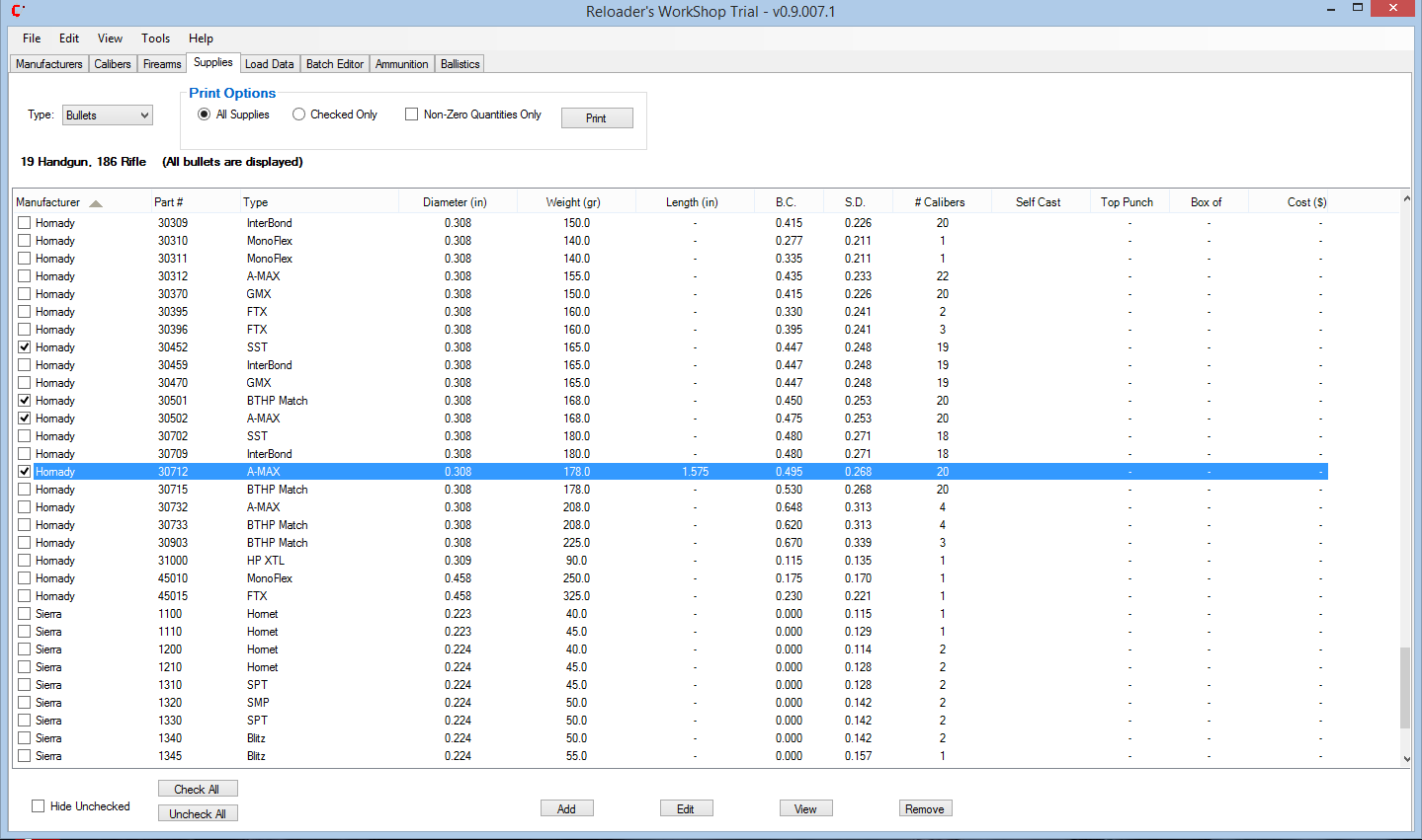

            Here are some pics of what this program can be used for. This isn't all of them but just some of the main ones.
            This screen is where you enter the min-max loads and anything in between from your manual.
            This is where you enter the caliber info that you want. The program already has most of the calibers that are SAAMI spec so you might not need to use this.
            This is where you enter your supplies such as powder, bullets, and etc.
            This is for entering specific loads. Once you shoot the groups then you hit the "Test Data" button and it will bring up the next page. You then enter your data there and then hit the "Target Calculator" button and scan in your target groups for that load on the next page. This is one of my best groups with my Howa. Of course I am not going to post any of the terrible groups that I have accumulated.
            This is the one that threw me for a while as you have to enter the caliber that each bullet is allowed to use or it won't list it as an option on down the line.
            I think this is the main stuff that you might use most.
