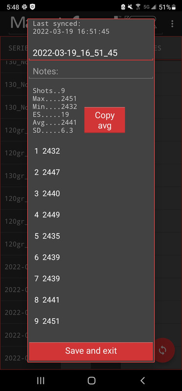

    For those of us with modern phones (note 20 in my case) you may find you don't have a headphone jack so there is no way for the xfr app to communicate with your magnetospeed data box. Pulling the SD card all the time isn't something I ever plan to do.
    Well.... I found a usb-c adapter that works.
    The only trick is to play with the volume. It likes around 90% then everything syncs consistently and correctly.
    That is all. Works perfect for me and saves the hassle of moving the SD card every time. Really wish they would just upgrade the box with bluetooth.

    This is good to know! Thanks Z_E
    We'll give it a shot!!!
