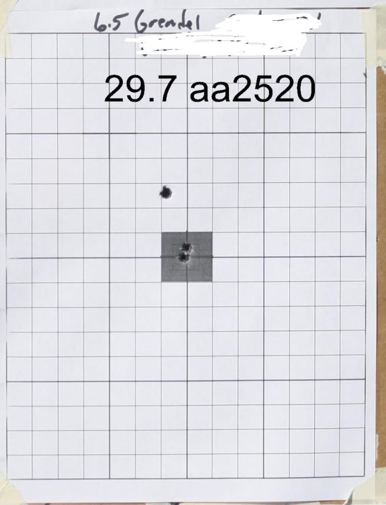

                  thanks for the info i will start at 26 of 8208 and work up. the sierras didn't do too bad for the first work up. going to start a little lower and work up would have like to get 2500
                  with them though. here is my best group of the day 29.7gn aa2520
                  I just thought the grendel out performed my 7.62x40 more than it does. i get 2500 with 110vmax
                  here is one of my 223 final load eval with cfe 223 10 shot groups. my meathod does seem to work for me it might not work for the grendel we will see

                    BD:
                    Just like you will find out that the 28 - 29 grain load of 8208 XBR will most likely be your best load with the 120 Sierra's, you will also find out that 30 - 30.5 grains of 2520 will be your fastest and most likely most accurate load for the same bullet.

                    • #11
                      Why only 3 shots?
                      • #12
                        Originally posted by Bwild97 View Post
                        Why only 3 shots?

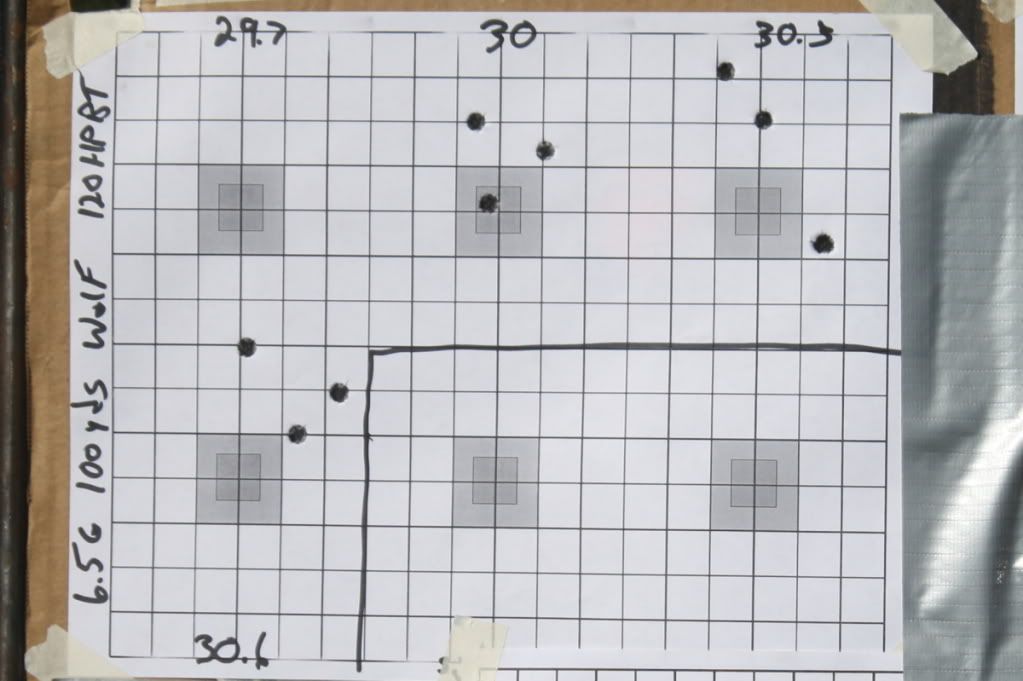

                        i do 3 shot groups in my ladders to save components when i find a couple of nodes i do 2 5 round groups of each and then .2 above and below also. it worked for my 223 and 7.62x40 loads
                        that was just the best of the ladder. here is the other pic
                        • #13
                          yep, after 3 youll know if its bad or good
                          • #14
                            3 shots just isn't enough proof for me when it come to AR's, 3 maybe from bolt guns. I like 8 shot groups, I feel better about making decisions toward my loads with good representation of the barrel/shooter combination.
                            • #15
                              I think it is, when you find the one that the group is tight, then you can burn more power and bullets fine tuning, look at the ladder system, thats only 1 per load
