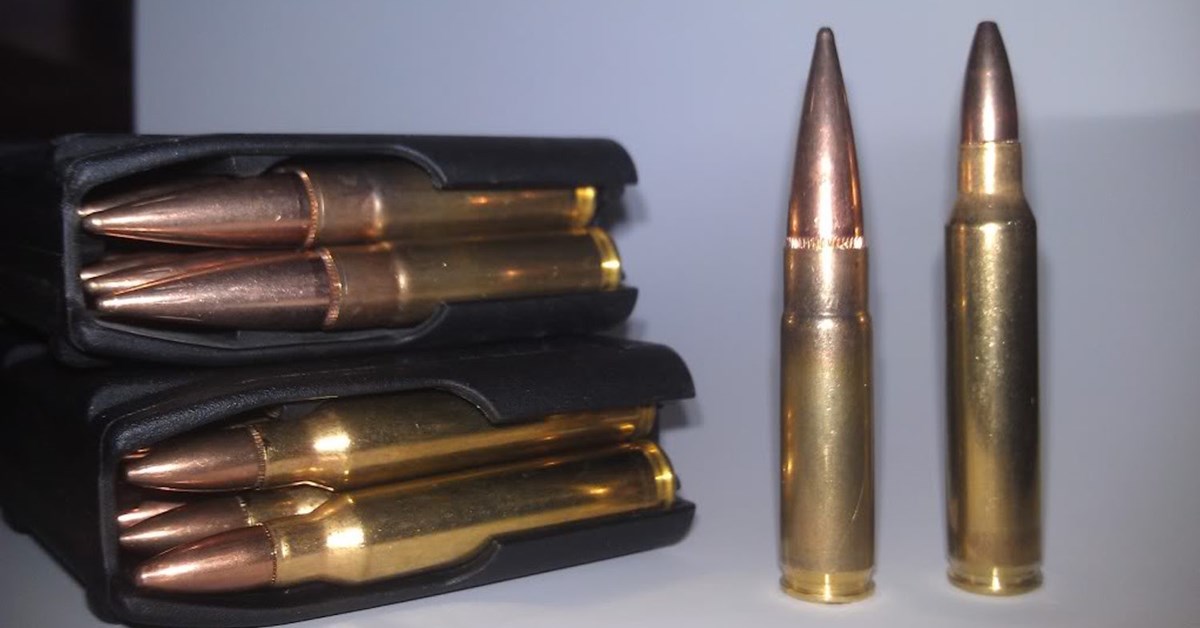

      The whole point (IMHO) of .300 blackout is maintain full-suppressed operations while maximizing terminal performance. Should subsonic ammunition not appeal, then the advantages of .300 blackout pretty much go away. So in your case, I would suggest just dumping it and going 6.5 Grendel.
      Also, .300 Blackout Kabooms are far more common then you might think; as the wrong mag gets loaded into a 5.56 chambered gun, and KABOOM. This is happening quite a lot in fact; and I don't judge - when out at the range or in-field things get grabbed and mixed up - I can see it happening. 6.5 Grendel won't fit in a 5.56 chamber, and so there's no risk of Kaboom from grabbing the wrong mag. .300 BO, not so much... [not my photos]. This is actually one of the reasons I went 6.5 G and skipped .300 BO
      4,782 likes, 302 comments - esydow13 on December 2, 2018: "Running a course of fire when boom. MY GUN BLOWS UP. Now before I start let me say this is not the guns fault. If it was I would tell you there’s no point of hiding something that is wrong plus it’s not morally right. So what happened was some how 300 blk ended up in one of my magazines. It’s common knowledge to keep the two rounds very far from each other so this doesn’t happen but mistakes happen you can never be to careful. - Also side note the @iwi.us x95 I strongly believe it saved my face this could of been very bad. The round did not leave the barrel so the gun received all the pressure. If there is a catastrophic failure the bolt is designed to lock up to control the pressure of the blast. - @drewhopkins for always keeping the camera rolling you really are the real MVP😘 - @iwi.il @vertx_official delta stretch pants - #300blk #iwi #catastrophic #failure #explosion #tavor #x95 #sunday #mistakes".
      The .300 Blackout cartridge is a flexible, innovative cartridge that's a step up from .223 but not quite the full-power of .308, all in an AR-15-sized rifle. However, accidentally loading .300BLK into a .223 gun can have catastrophic consequences.

          Surely would NOT want to hunt with or be around any of those people. Always use KISS, no 223 when shooting the 300 BO plus black metal/Lancer mags for 300 and fde magpul for 223. JM2C

            ^^ This! In my case black P-Mags for blackout, FDE P-Mags for .223, and I am the only one who touches the mags and bullets when loading them.

                    As to operator error. Agreed. Nonetheless, .300 BO is a specialty round, with a larger portion of users who are more serious, rather than casual (i.e. should know what they are doing). IMHO, there is an systemic safety defect in the concept, and it's materializing - .300 BO KABOOM reports at about 1000(?) times the rate-per-round as 5.56 KABOOM reports.
                    My extreme straw-man argument is if I take red-button that will blow up in a room, and label it "red button that will blow up the room", and leave that in the break-room; it's a matter of time before someone pushes that red-button. I can blame the guy for pushing the red button, but as an engineer who designs dangerous equipment, I have to look at that go: could I have designed this system better so that red button didn't get left in the break-room? That's how I view .300 blackout. It's like if the .357 Magnum developers deciding to color all the casings red, and then just make the casing .38 special length. Mechanically that's equal and would be more efficient after-all, right? Do that, and a lot of people are going to KABOOM. Recognizing that reality, they designed it so you just can't fit a .357 magnum into a .38 special. The engineers of .300 blackout... did not. And guns are KABOOM'ing. In my observation, they are KABOOM'ing a lot..
                    Another example of blaming operator error on a development safety defect, is a certain brilliant gun designer who makes a plastic gun-case with a post that fits inside the trigger guard of his gun-case, to help secure the structural strength of his case. And then blames users for discharging their guns when they case them; which happened a lot. But because the manual clearly states not to store a loaded gun in the gun case, it was operator error. This actually happened to Mr Gaston Glock, who called his early American purchasers idiots and it was their own fault, until his staff forced him to redesign his beloved Glock 17 TupperWare pistol case anyway, because it kept happening. Sure it was operator error, but it was an inherently unsafe concept that was readily prone to operator error.
                    My opinion: the developers of the .300 Blackout engaged in systemically unsafe engineering that is prone to operator error, that is resulting in a lot of KABOOMs - no different than if they made .357 Magnum's fit into .38 Special revolvers. And unless one is going to shoot suppressed with subsonic, one is well advised to stay the Hell away from that .300 blackout pistol round. I would rather they did a 10mm version shooting standard 10mm casings, but loaded long (if you wanted to) with subsonic pointy 230 gr bullets; or standard 10mm ammo if you wanted, but that's just me.
                    They let the design criteria of fitting into a standard AR magazine well using a standard 5.56 AR bolt, overrule the safety consideration of the inevitable KABOOM's that thing is going to be doing; and now is doing. The only silver lining is AR's are so inherently safe, that most KABOOM's don't result in any injuries (it's actually pretty impressive, Eugene Stoner was a genius).
                    Anyway, that's just my opinion - and my very long winded basis for why I would advise anyone trying to decide between the .300 BO pistol-ballistics round, vs the 6.5 Grendel rifle power round; to go with 6.5 Grendel pretty much every time; even suppressed.

                          If most every other cartridge is designed so you cant fit the larger diameter bullet in the smaller one, there is merit to lazyengineer's point. If this isn't a design safety issue why isn't the .308 family of cartridge all using the same brass?
                          Add that you can swap uppers easily on the same rifle, and you increase the likelihood of making an error.
                          I agree it's operator error but you have to make things idiot proof.

                            Also, I misspoke, .300 BO is not "inherently" unsafe, it is more "systemically" unsafe. The system is readily prone to catastrophic failure from operator error, which is now happening on a far more frequent basis than any other round.
