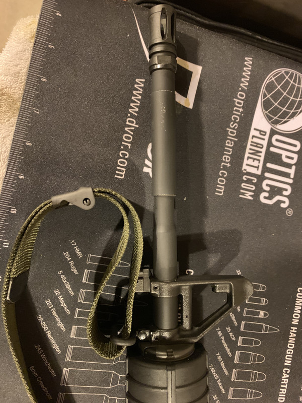

            I have that same basic upper but my barrel is not chrome lined and is a 4140 CMV with 1:9 twist barrel and Phantom flash hider. My barrel has been a very good barrel. I have been well pleased with the accuracy as it usually shoots better than my ability. I built this 6.5 Grendel to match my 5.56/223 duty rifle. I normally use a Leupold Mark AR 3-9x40 mildot scope. I have a red dot sight and irons I throw on it from time to time. Typical accuracy with Wolf steel case is about 2.5 MOA. Wolf ammo is very inconsistent ammo for me regardless of which 6.5 Grendel AR-15 I use.
            The carbine gas system is not quite as versatile as mid length gas 16” 6.5 Grendel IMHO. I have no regrets buying this barrel as I don’t use a suppressors.

                  RGuns has nice set-screw type FSB?s for like $25 bucks (front sight parts included). The set-screw under the swivel lines up with the dimple on most barrels. I used the last one on a Grendel M4orgery.
                  A bit of Loctite 638 on the FSB rings and Rocksett on all 5 set-screws I have zero concerns about it moving...ever...
