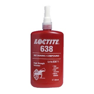

      Receiver lapping is something I also do regardless of upper or barrel manufacturer. I also use a little but of Blue Locktite between the barrel extension and the upper receiver, not on the threads but where the extension meets the upper.
