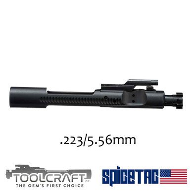

                              FWIW, I just ordered a couple of these Toolcraft BCGs in 5.56. One for myself to have as a spare and one for my nephew for his new build:
                              Trusted by the US Military & backed by a lifetime warranty, Toolcraft's Black Nitride BCG features extreme durability and reliability in its function.
                              They sell these in both Nitride and Parkerized+chromeline. I chose Nitride because it's less expensive $15 or so. LOL And it'll be good enough for us. Normally though I'd go milspec with the park+chrome.
                              There is also a selection to chose between C158 and 9310 steel, whichever you prefer. Same price either way.
