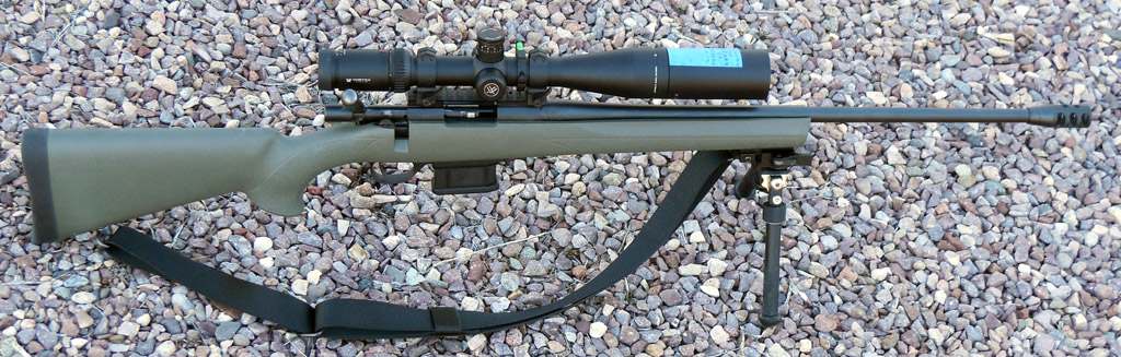

        My standard barrel was thick enough for 5/8" threads:
        Also, most of the "223" brakes I've seen have huge thru holes. I put one, unmodified, on a 338. I suspect that a lot of AR barrels are threaded in a haphazard way.
