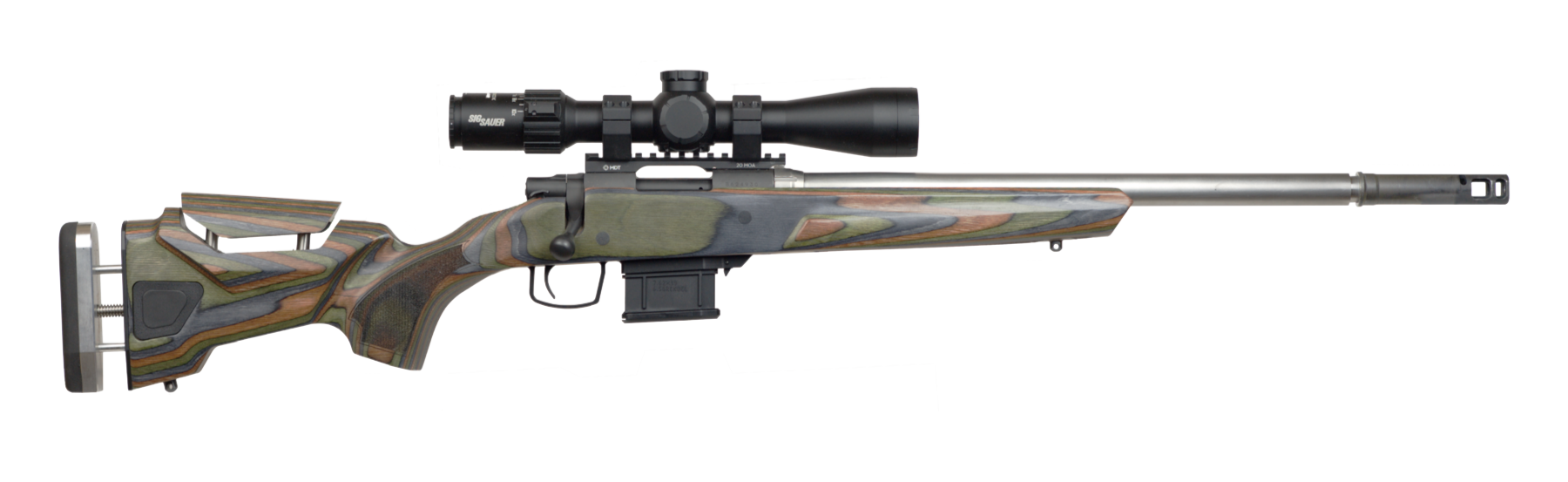

    Howa Mini: custom barrel, Boyd's Agility stock
    Barrel is a custom 19.5" 1:8 5R prefit from Crown Ridge Barrel Works; it uses a Savage small shank barrel nut. The Agility stock includes aluminum pillar bedding and adjustable comb. Bottom metal is a DIP aluminum unit.
    It took some doing to open up the barrel channel on the Agility stock, but I do believe it was worth it. The rifle shoulders extremely well and is a pleasure to shoot, especially with my Surefire can attached.

        Thanks fellas. It does well with the Berger 130 Tac Hybrids.

          That is a nice-looking gun. How much does that stock weigh?

            Thanks - just over 3lb.

              what does the whole rig weigh in at??

                9lb 12oz according to my scale. That's with an empty 5rd mag inserted.

                        To the OP and others who have used Boyd's stocks, is there much work to be done to get a good fit between the action and stock?

                          Not for me, but I got the optional aluminum pillar bedding. I did have to put in some work opening the barrel channel so my aftermarket barrel would free float, but I knew I'd have to do that going in.
