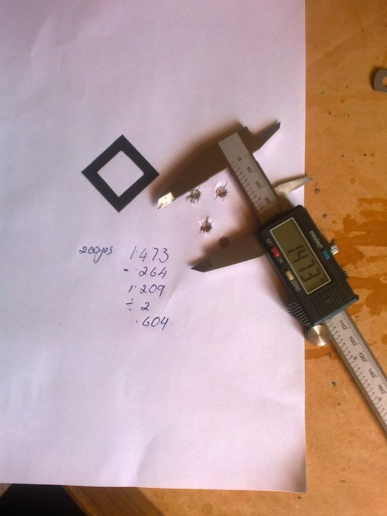

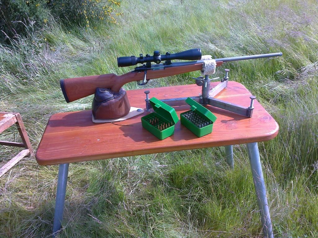

    Okay, after all this time, here are the initial pics and report. I got the inletting finished last night and then did the bedding so this morning I finished the shaping and got things to the stage that I could get a first coat of oil on it and then impaitence kicked in and I decided I could finish the oiling AFTER I had been to try it out. Five shots to get it on at 25 yds then a few more to get it somewhere close at a hundred. Only had preped the one box of Hornady Grendels so fireforming to my GM chamber, but will do for now. At least I know it will be a shooter. Weight is right on 6 lb 12 scoped and ready to go and 7 lb 6 with the suppressor on board. Had limited rounds but with four into .58 I guess there is something good to look forward to. Next time out I will take the chrono to see what the factory Hornady A Max's are doing as a fireforming velocity.
    .84 -.264 =.58

      very nice stuff gruff! Im going to hazard a guess and say you didnt buy that rest at your local gun store! You are one creative guy, keep up the good work. And one day, maybe some details on the rest.

          Took couple more pics but the stock is a utilitarian affair rather than a show pony so form and function were the aim with light weight being desirable.

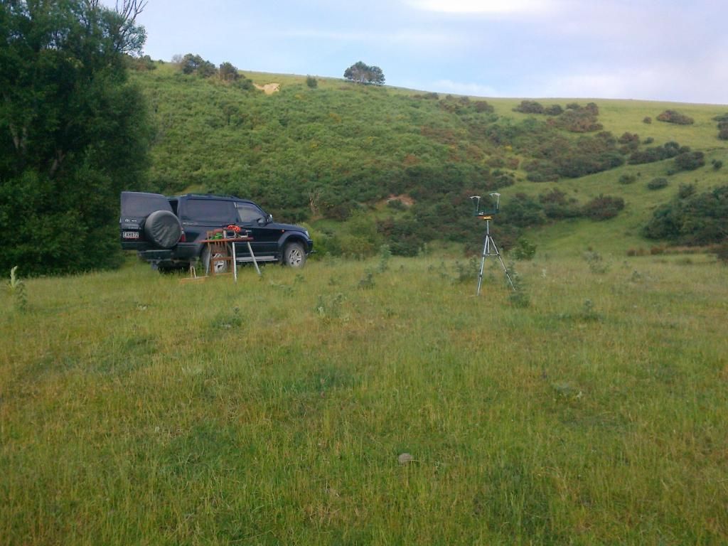

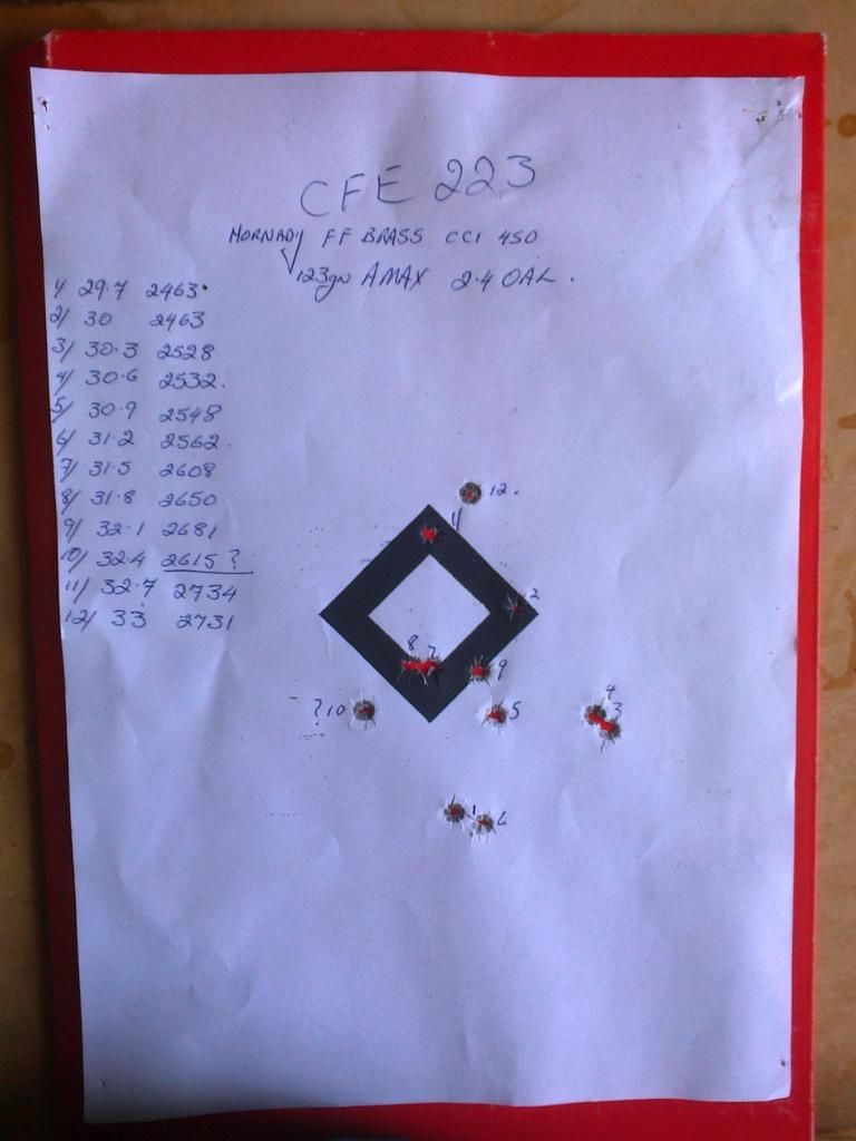

                Okay here is the first real shooting results. Was up at 5am this morning and away by 6am to get some shooting in before the early morning breeze that often kicks in - but didn't this morning so it was calm. clear and mild at about 14 degrees C.
                Target at 200yds
                Chrono at 15 yds
                Hornady fireformed brass
                CCI 450's
                123gn A Max's
                OAL 2.400
                21 inch barrel
                1 in 8 twist.
                Ladder test with CFE 223 and BL-C2
                6 am - daylight but before sun over the hills.
                I did not bother with the marking rounds with different coloured pens. I would fire one round of CFE and one of BL-C2 at thier respective targets and walk down range and mark them on the paper and this allowed me to have a more controlled temperature for the barrel at each shot. Did the slow deep breathing to slow heart rate after the walk but got a reasonable similar condition for each shot so results are of some value.
                I dont know what happened with shot no 10 in the CFE 223 test as it was way down in expected velocity although I suspect I may have loaded it at 31.4 rather than 32.4 as it is very close to the no 7 shot of 31.5 giving 2608, but 7, 8 &9 are in .741 c/c at 200 but will run another test with the 7 through 12 loads and will run the bL-C2 9 through 12 loads again as with a 1.14 c/c at 200yds for the 4 different powder levels this definately shows some promise.
                Some interesting times over the next few weeks. but it does look as if I should get a reasonable load in the close to 2700fps range with the CFE but maybe only into 2550 - 2575 area with the BL-C2

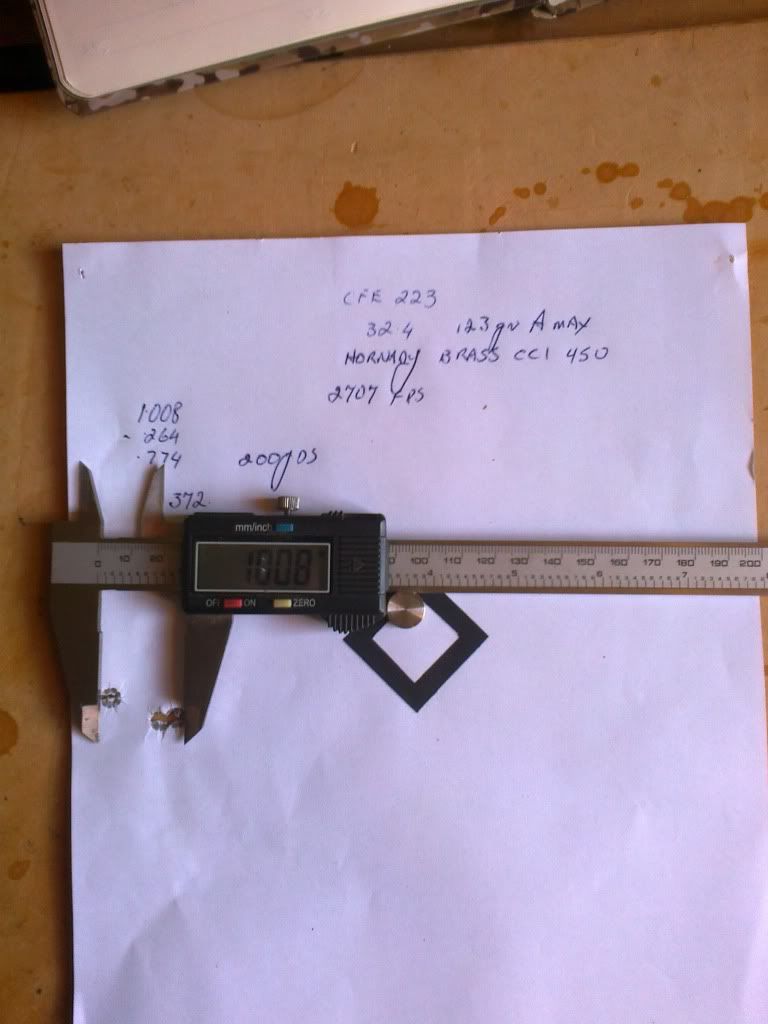

                    It was another early start this morning and I took my loads of 31.5 - 32.7 CFE 223 and 32.1-33.3 of BL-C2. I know some on here decry the use of three shot groups but I am confident enough of reading my results to use it for preliminary testing. I decided to curtail anymore testing of the BL-C2 even though in the 33-33.3 range it was showing nice round groups in the 1 1/4 at 200yds. The CFE 223 loads showed a node just over 2700fps that I will chase down a bit now.
                    I have loaded up some 5 shot groups to re test this load and if it comes off I will be more than satisfied. The 123gn A Max at 2700fps is all that I imagined the GM case would produce for me and if I can stay in this accuracy quadrant, then this experimental light rifle will have more than justified itself and earned its intended position as my go-to hunting rifle.Will only have to swivel my bench a couple of degrees from where I set up and I can get another target set out at 350 yds and realisticly if I can get them into under 3 inches there I will be very happy and consider that I have a real 500yd rifle as at 2700fps at the chrono I will still have 1900fps and expansion, even with the A Max out at 500yds. It really does look like this GM has born out all my thoughts when I was doodling on a piece of paper.

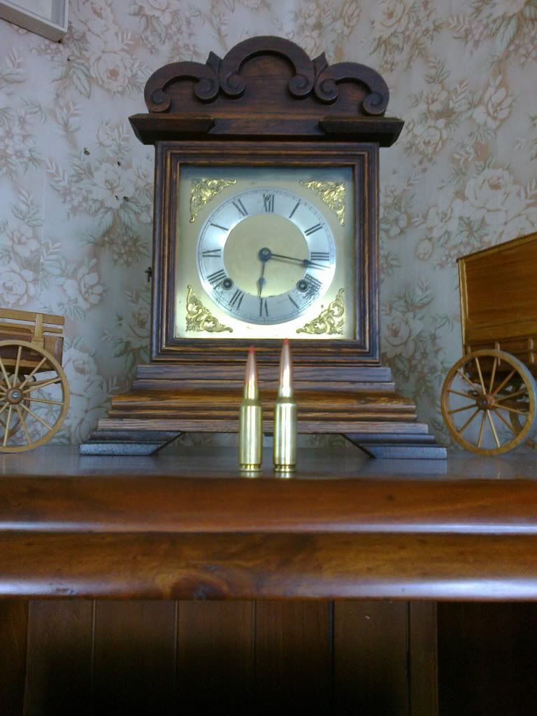

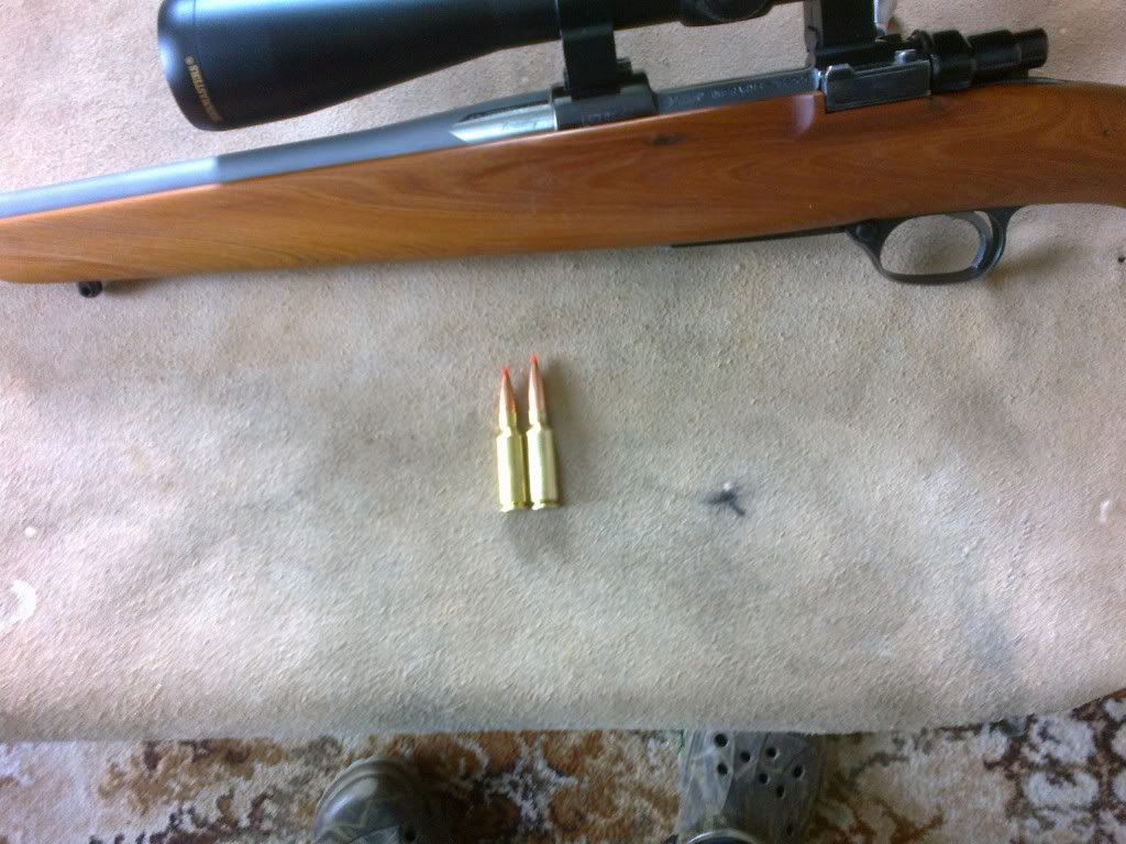

                        Can we have a pre and post FF pic please? See a couple of cartridges in the rifle pics on prev page.What are they? For a home made rifle, that is one sweet shooting piece of kit!

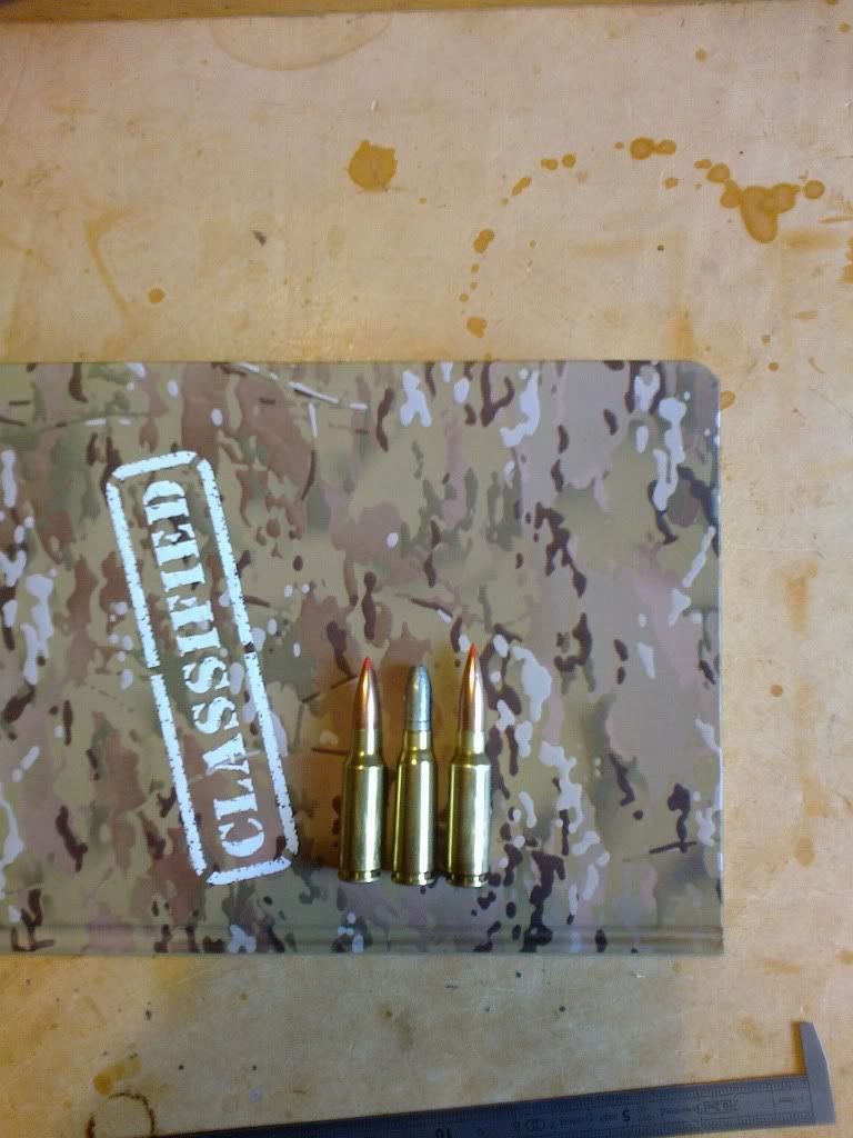

                          Her you go eljefe. Pic on previous page was attempt to show the Grendel with the GM case but wasn't clear enough - cell pic.
                          Will try a couple more.
                          This is a Hornady Grendel and a FF and reloaded GM cartridge with OAL of 2.405
                          This is a Lapua x39 case with my FF cast load of 5.7 gn Red Dot with a GM -A Max
                          This shows the Hornady Grendel with the x39 case/ cast bullet and the GM / A Max

                          • #58
                            Thanks for the close ups, Von G
                            Seems all the precisoneering with the fireforming and the crush fit is paying off.
                            Good luck on the 350m laddering and then I guess its the turn of the cast boolits?

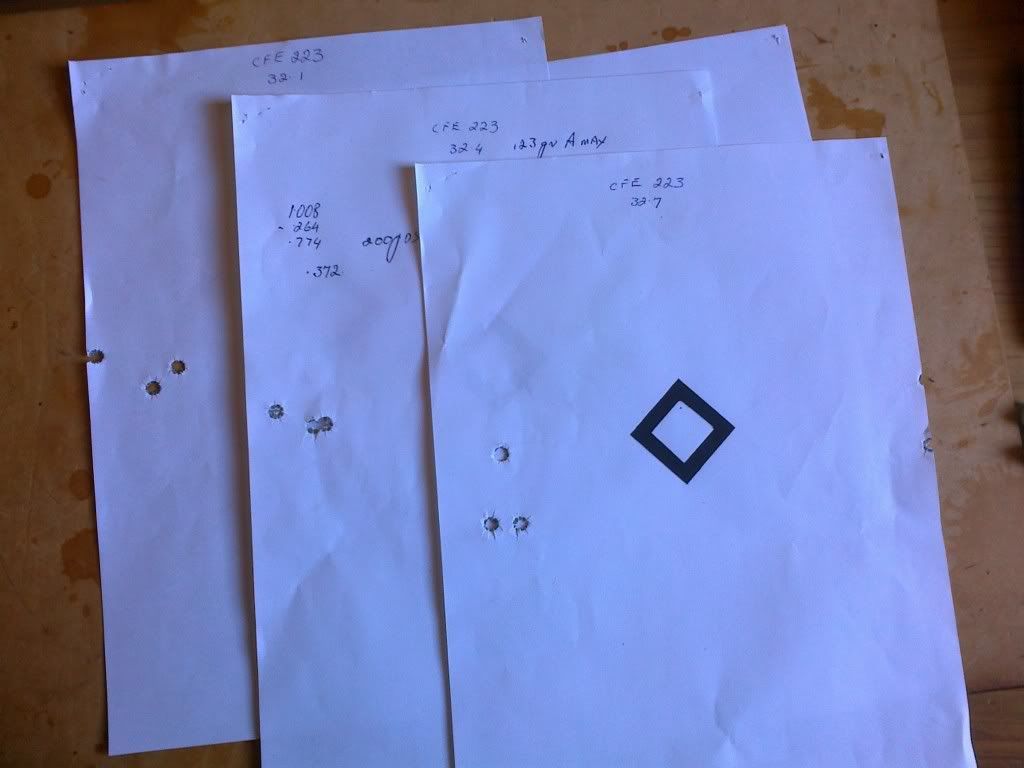

                                Well I think I have this little rifle worked out.
                                I was out this morning again and run a few more groups through at the 32.4 for a reasonable return and holding in the .5-.6 region
                                But it was the 32.6 gn loads that really got my attention and decided me on my future loads. the wind was getting to be a factor by this time and I only use two staples on the top of the target so that any breeze will fluter the page and I only shoot when it is still. The bull rushes in the middle distance work like a wind flag and I can feel the breeze on my face at the bench and even though I missed the wind call on one shot and blew the group. it does look as if a sub half inch result should be gettable.
                                Next day out will be scope setting for the 200 zero and trying at 350yds
