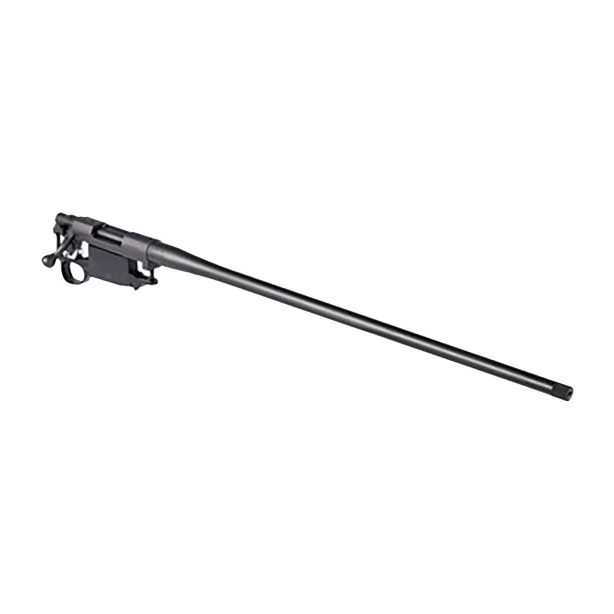

        I would buy the thin profile 22” 6.5 Grendel action and have my Friend who is a gunsmith cut it at 16.5” and put a nice crown on the barrel. I’d look at a light weight stock, maybe carbon fiber. The action weighs less than 4 pounds and cutting 5.5” inches will get the action close to 3.5 pounds. Add a Jefferson Outdoors flush internal mag with floor plate and light scope rings. The barrel is pretty light and no need to re-profile or thread.
        Sell or keep your other Howa, no need to remove the barrel or have the barrel sent off.
        Check out HOWA M1500 MINI 6.5 Grendel 22" Standard BBL 1/2"-28 Thread Blued SKU: 430103509 | Brownells available Online at Brownells Today and many more Rifle Receivers & Parts products are available in our Gun Parts Department.
          https://www.brownells.com/gun-parts/...?sku=430103509
          That's what I have in my cart ready to order.
          Barrel profile is still to heavy for my wants/needs.
          May just go ahead and have a custom barrel spun up.
          I'm looking at coming in in the 4.5 to 5lb range total weight, loaded and ready to kill.
          I forgot to add, the action is getting sent off as well to have the bolt fluted and the action slabbed. Cutting the weight down even more.
          Cutting down the carbon stock forend length and removing the standard 1 inch butt pad and replacing it with a 1/8 pad will take it from it's advertised weight of 18 onces to around 11 onces. Did one this summer for a friend of mine, came out great.

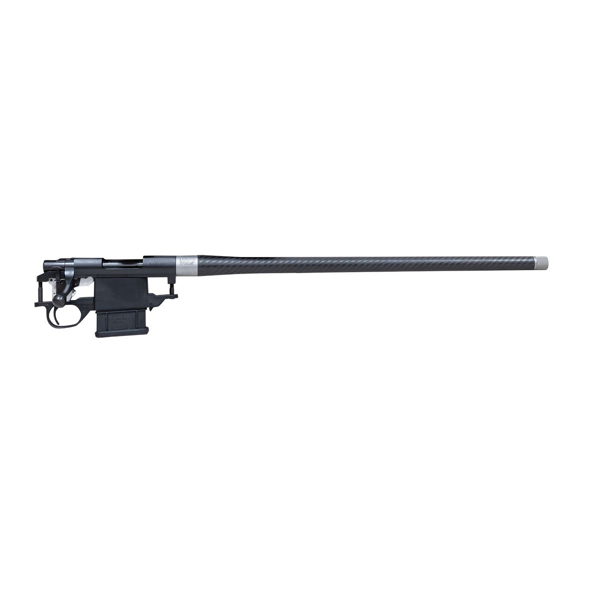

                        A howa mIni carbon elevate with carbon stock and barrel is 72 ounces
                        • A5Blaster Number 2
                          • Nov 2024
                          • 131
                          And it's to dang long.
                          That and I don't trust their weight they say it is. Buddy's creedmoor was a good bit heavier then advertised.
                          • Draftpick
                            • Dec 2021
                            • 47
                            That 72 ounces i can verify as i weighted on my scale, it's that light much easier option than your custom route
                            • Draftpick
                              • Dec 2021
                              • 47
                              Check out HOWA M1500 MINI 6.5 GRENDEL CARBON FIBER BARRELED ACTION | Brownells available Online at Brownells Today and many more Rifle Receivers & Parts products are available in our Gun Parts Department.
                              Carbon fiber barreled action add your stock go shoot
