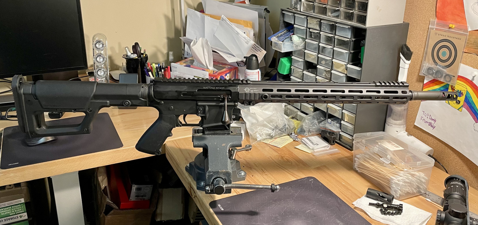

                        Got the upper in today. Swapped out the barrel, bolt, and handguard. Everything is standard AR15 except for the carrier and cam. Cam path is very different from a standard AR15 - just straight back, no dogleg. I left the buffer tube and spring in place to give little bump to returning the bolt to battery. You really have to be positive with your manipulations to get reliable extraction and feeding, especially with a full mag.
                        Optics mount is arriving tomorrow, then I can do some zeroing and initial accuracy testing. The barrel is an Odin Works 18" stainless.

                            I used a pair of groove-joint pliers with the handles shoved into a cheater bar to get the barrel nut off. Seemed torqued to the higher end of the spec, but ultimately no big deal (especially when compared to a bolt gun barrel). I did use the included barrel sleeve on my replacement barrel -- single set screw, easy peasy as long as your gas block journal is .750". My AR15 receiver blocks worked just fine, as did my Geissele reaction rod.

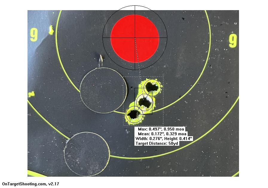

                              The BCA upper works well! It's very fun to shoot, especially suppressed. No gas to face, very quiet. Extraction must be very positive on your part, but it's not a problem. Bolt lift is just a few degrees so it's pretty darned fast.
                              Decent accuracy for shooting with frozen fingers on a milspec trigger. These were 120gr Barnes handloads using TAC. The group is below my POA due to the suppressor being added after zeroing.
