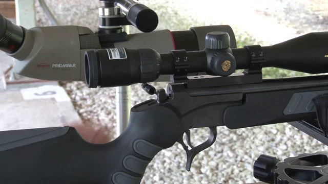

          Here is a short video I put tgether on a 6.5 Grendel Encore I built for my daughter-in-law.
          This is a T/C Encore that I built for my daughter-in-law, Cati, to use on her first elk hunt. I wanted it to be simple and straight forward for her to use. I also…
