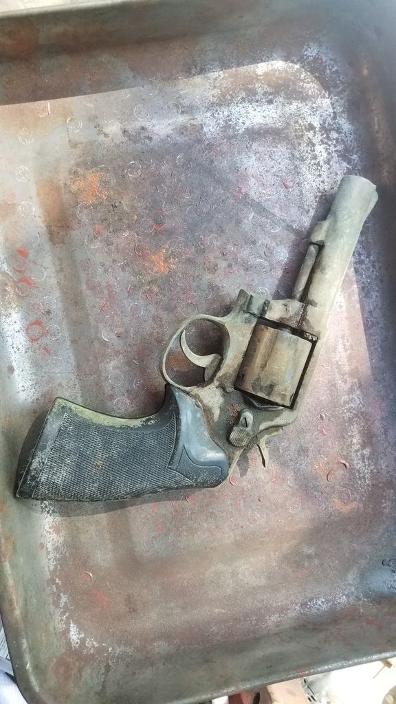

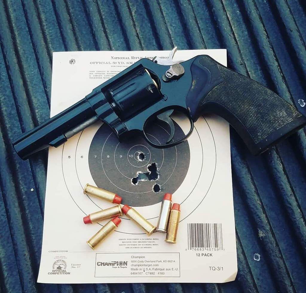

                                This is a Smith 10-6 that I rescued. It is done with Brownells Gun-lots and baked.

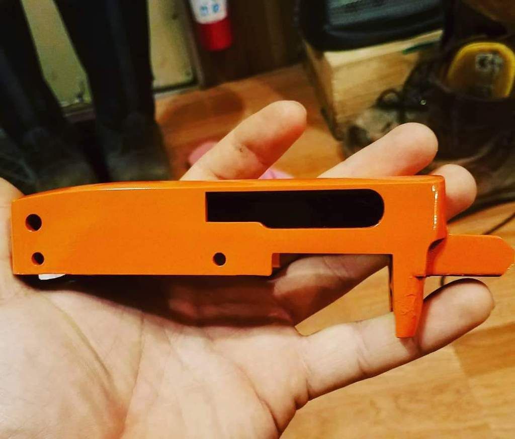

                                10/22 reciever done with Tacoma Screw high solid paint and baked.
