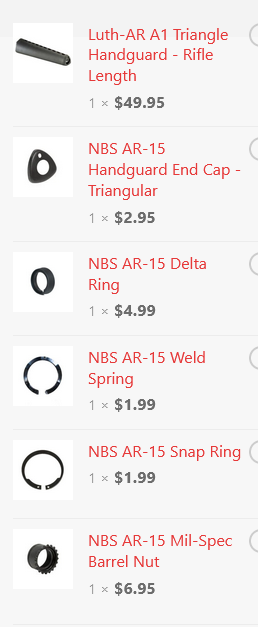

      Is this everything I will need?
        • 6488
        I used a JP Enterprise adjustable gas block with a receiver height rail and it has enough mass to attach the hand guard cap or keep it in place. JP has apparently discontinued this adjustable gas block but Primary Arms shows an out of stock gas block of similar design. Here is a link to PA. Another option maybe to use a fixed gas block with an adjustable carrier key or an adjustable bolt carrier. I used an adjustable carrier key on one of my builds but it was way over gassed. The adjustable carrier key let me adjust the gas but once set I doubt I will need to change the gas setting. The Bootleg adjustable gas bolt carrier would work if you need to change the gas for suppressor or different ammo.
        https://www.primaryarms.com/lbe-railed-ar-15-gas-block-upper-receiver-height-750
        https://bootleginc.com/product/bootleg-four-position-adjustable-carrier/
        https://www.righttobear.com/rca-adjustable-gas-key-1ad-gky/
