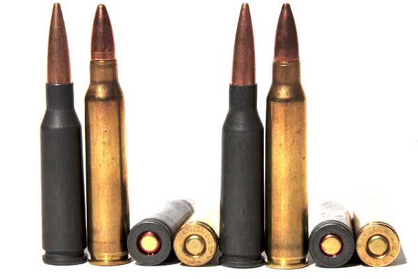

              P.S. I am surprised that 5.45x39 reportedly worked well in (stretched) M27 links. Because the base-to-shoulder dimension of 5.45x39 is little greater than on 6.5 Grendel, I would've expected you to encounter the same issues with the cartridge stop and feed pawls as I noted above. Did you have these issues, and if so, how did you deal with them?

                On the 5.45 - I am going off of what MGA told me, I made them a barrel and modified a bolt/extractor for them and they shot it. I do have a barrel core made up for myself, but I have yet to populate it and shoot it.
