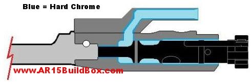

        • 9294
        Bolt carriers are the same for 6.5 Grendel, as long as the Bolt Carrier meets the TDP dimensions and material qualities.
        If the carrier bore inner diameters are not correct, it can lead to gas system problems with a leaky set-up (too loose IDs).
        Notice the 3 inner diameters of the bore where the bolt cylces inside, starting with the orifice, then the compression ring section, then the tail.
        One common problem with most of the special coatings carriers is they end up being too loose, because they use the same machining dimensions for a Mil-Std carrier, but don’t then apply the hard chrome inside this area that is part of the TDP. Most of the coatings are a lot thinner than hard chrome, so the finished product is not in-spec.
        Actual TDP-compliant bolt carriers are the safest bet, and only a few companies are known for consistently cranking them out, some of those companies experiencing degradation of standards compliance in the last few years due to the new wave of young employees who have never been held to any standard before entering the work place.
        As to bolts, Nickel Boron typically causes hydrogen embrittlement like Hard Chrome does, so I avoid it in AR-15 bolts even in 5.56.
        I went through the phase in the 2000s through early 2010s experimenting with the different coated BCGs, like Titanium Nitride (TiN), and Nickel Boron (NiB), and after long-term testing of them in the Arctic, we didn’t see any real benefits over a real Mil-Spec BCG. (Most BCGs are nowhere near Mil-Spec)
        For Grendel, my go-to bolts are the Rexus in a Bootleg Adjustable Gas Carrier.
