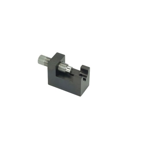

                    Cleaned up bolt face after photos. Felt for burrs on the bolt face on either side of the extractor & indeed this was an issue. Managed to make some progress removing those burrs. Would really like to remove the ejector & extractor to better facilitate a good polish of the bolt face. Unfortunately I do not have a proper punch to remove the retaining pins. GRR
                        Brownells has a bolt vise for removing the ejector from AR15 bolts. They have pin punch sets too ...
                        Check out SINCLAIR INTERNATIONAL SINCLAIR AR-15 BOLT VISE available Online at Brownells Today and many more Fixtures & Blocks products are available in our Tools & Cleaning Department.
                        Brownells is your source for roll pin punch sets at Brownells parts and accessories. Shop our vast selection and save!
