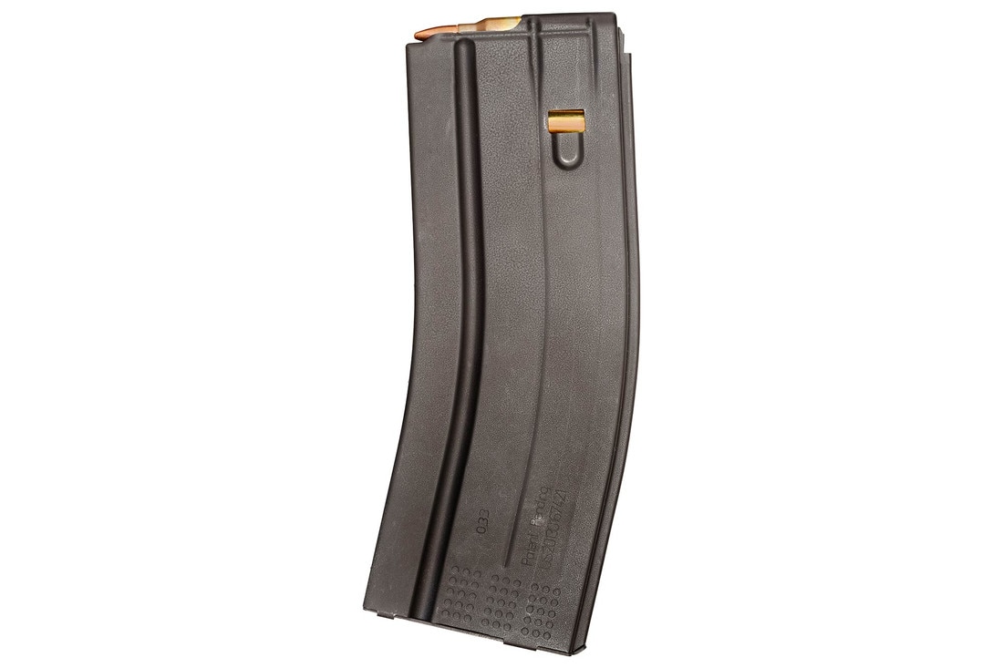

    I'm starting a thread for this mag so we can get some feedback for the forum on how it works. It appears the initial production run was way too tight in most mag wells, requiring both arms and knees to remove from AR15s.
    This was supposed to be addressed with the next run.
    If it works, it could be another option for mags for us.

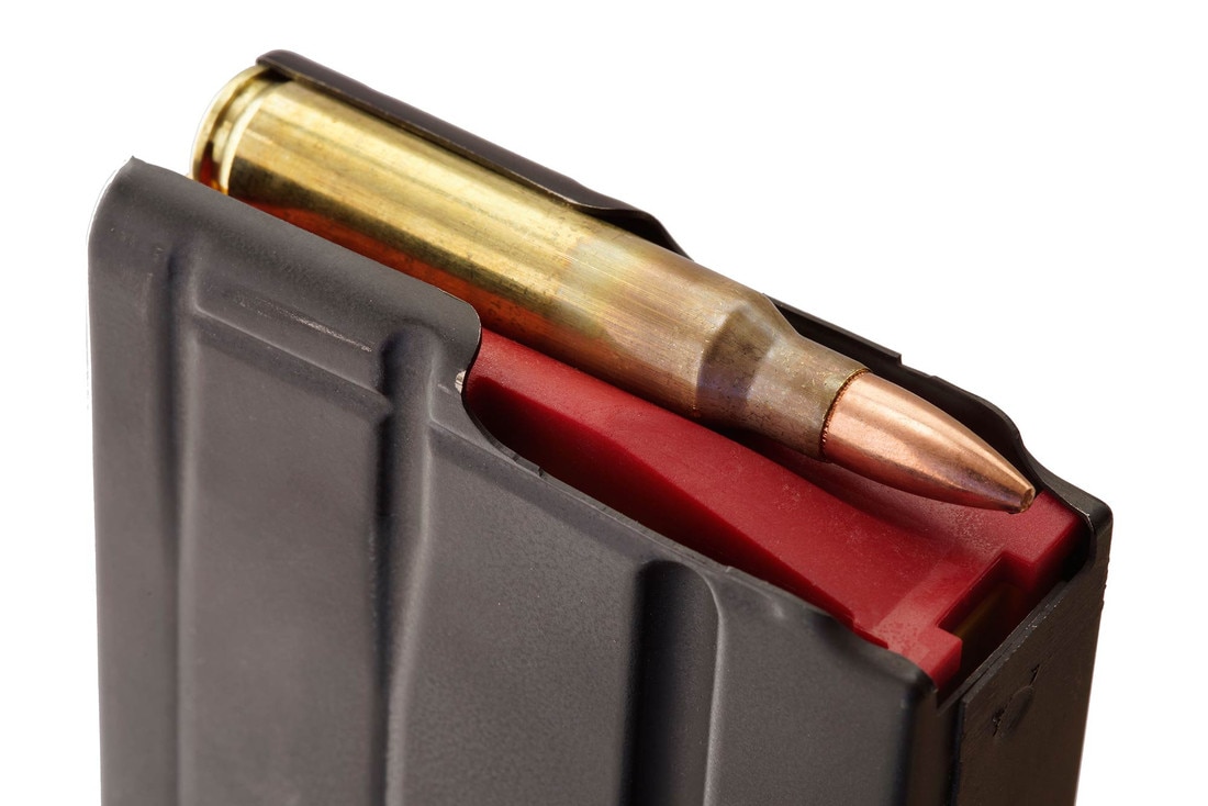

      Why is the red follower reversed- in the 2 pics, with what looks like a 5.56 round inside-? Is it metal lipped, and poly bodied?
        It has an articulating follower that equalizes orientation based on what cartridge you load in it.
        There's a spring guide that has pivot points for the follower to hinge on, so it can adapt to different case tapers.
        It's meant to load and feed 5.56, 7.62x39, 6.5 Grendel, .300 Blackout, etc.
          Sneaky, I see what your talking about its not reversed its just the angle the pic was taken at that makes it look that way.

            Still no answer on the poly, Yes A5 the picture was reversed. BFT is a photo shop wiz. I'm guessing he had a time in this pic- it's what he does.

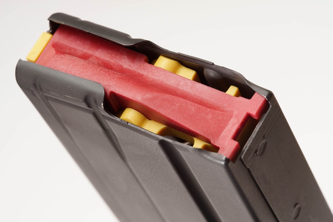

              The center internal - vertical guide is too deep into the ammo column at the top- see it? That's why it is bulging with the AK, & Grr rounds- needing a huge effort to extract the mag. Maybe a softer spongier mtl. is needed. Or keep the internal ribs as same as the 5.56 in that area.

                I ordered one of these to play around with. It is supposed to work with 5.56, 6.5, 6.8, and several other calibers. Thefollower is two piece with a "teeter totter" hinge for the lower part to allow the back of the follower to bend down to accommodate different size cases.
