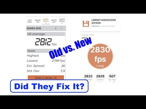

    Gents,
    Labradar has updated its firmware to 1.3.3. According to Tom Mouser the sales rep it is to smooth the Bluetooth connection with your phone app.
    New Phone app is also available.
    There is some feedback online about it. This video from F Class John
    Haven't used it on the firing line yet so no comment.

                Used the latest app on an iPhone with the Labradar 1.3.3 at the range.
                The app froze twice during the shooting session. Went into an endless loop of 'data transfer' where the only remedy was to get out and delete the whole app. Then reinstall it. The Arm button on the new interface screens takes a while to figure out where this is. Also still trying to figure out how to transfer data from the app. There is now the ability to transfer info in CSV (Excel) files but have not had time to explore this.
                Still no ability to go back and add shots to previous strings which is a pity.
                Obviously still a work in progress.
                I send this feedback to the Labradar guy, Tom Mouser.
