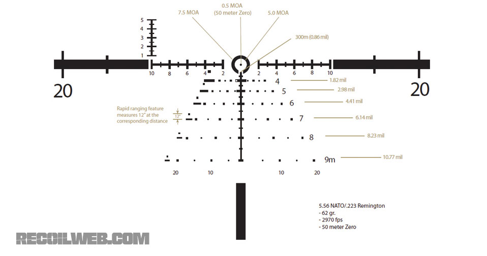

                          Roger. M24's are gone now. Only 7.62 NATO system being used is M110/Mk11, and they are leaning to 16" uppers for those, with telescoping stocks. The only bolt gun chambering in the Army is the .300 WM M2010, until just the past week, where the PSR contract was finally awarded to Remington, and that system brings with it the .338 LM.
                          There seems to be a large trend leaning more towards the Horus reticles, although my experience with them has been difficult due to the busy nature of the stadia, but I did not train with it as much as the Horus proponents either, so I'm not the one to really cover-down either way because of my bias towards dialing. One thing that has really stuck out to me from guys who have been using long-range rifles in a military capacity over the past decade + is that they all talk about how important using the reticle is, and knowing where elevation holds are for time-critical shots, while leaning to dialing if the distance and time allow for it.
                          With the new optics SOCOM is buying, there seems to be a preference for the Horus system, or variations of it when looking at the Leupold CMR reticle in the Mk 8 scopes, but those lines seem a bit thick for my taste:
                          • #14
                            With the Mark 8 1.1-8x24mm CQBSS, on high power only the fine stadia of the H27D reticle are visible and on low power the heavier stadia immediately lead your eye to the central red (if illuminated) dot without any obscuration. As you say, dial or use the reticle as time allows or demands.
                            • #15
                              People should keep in mind highly successful lobbying/promotion has played at least some role in the rush to Horus by some of the Military. I personally can't say how much but I do think people should keep in mind it may not be as much of a pure "grass-roots 'that's what all the users want/ask for'" deal as it may seem to some on the outside.
