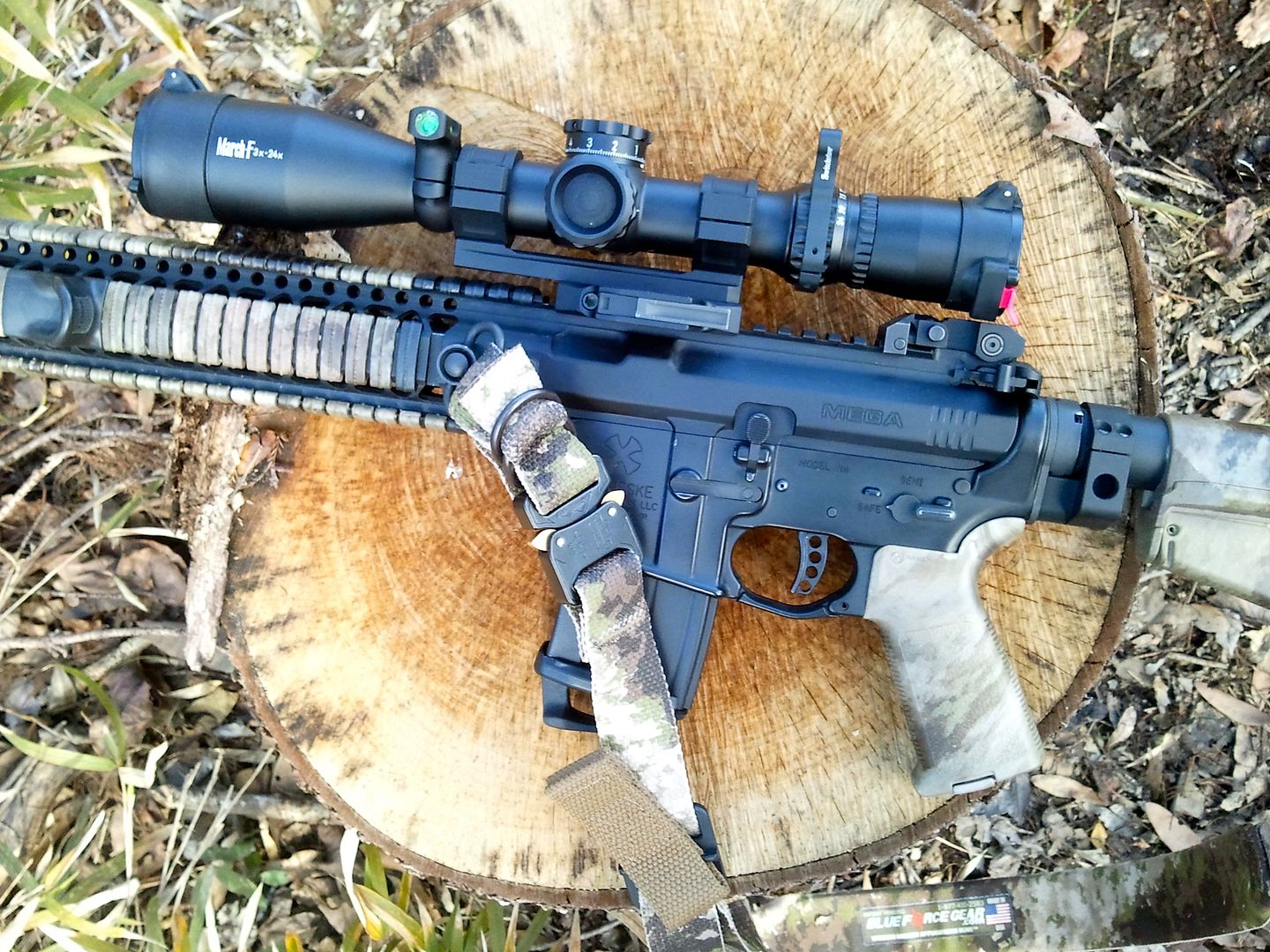

                            Drifter, what is the advantage of using the big larue mounts instead of the nightforce lightweight rings that come with the scope?
                            • Drifter
                              • 1662
                              When scoping an AR-15, pay close attention to the two things: scope height and eye relief. For height, the centerline of the scope needs to be ~1.5" above the rail. Eye relief seems simple enough, but you want the mount to be in contact with only the upper receiver (and not the handguard). The AR-specific cantilever-style mounts from LaRue, ADM, Bobro, etc are designed to address both aspects (height and eye relief), and many models have a quick-detach feature that return-to-zero amazingly well when removed and replaced.
                              The rings that come with a Nightforce scope are too low for the AR-15 without some type of riser. Nightforce offers an AR-type cantilever mount, though I don't think they have a QD feature (which may or may not be desirable for you).
