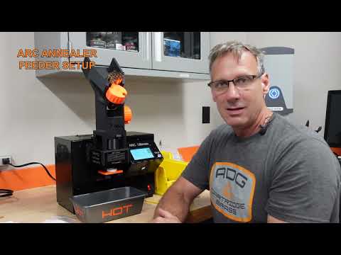

    This annealer uses temp sensors to stop at whatever temp the user chooses in the screen interface. No flames or fire or time based.
    It also comes with an autofeeder that mounts on the top of the machine or you can feed the cases by hand without the feeder mounted.
    Here is a new video showing the operation of the machine and the autofeeder and how the autofeeder is assembled.

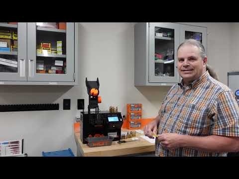

    Here is a video explaining how to adjust the height and heat settings.
