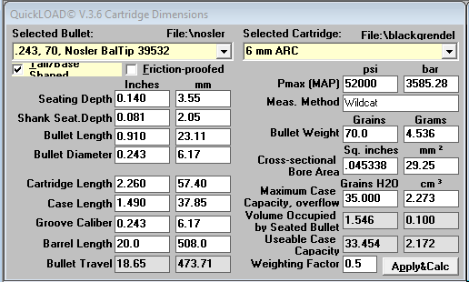

      barrel length, case capacity in grains of water, and what specific pills? actually.. im not even sure my ql has the arc. they have a 6mm arcH, something ive never heard of before but once again, i am a stupid moron with limited reading ability.

                so the arch is not the arc. the arc is pretty close to the 6mm ar, and i modified that data with the sammi drawing. cross sectional bore area i figured should be the same, and i 100% guessed on water weight/volume @ 35gr.
                Given all these caveats... also need seating depth. inputting 2.260 with the 70gr is not looking right with a shank seating depth of less than 1/10th of an inch. i could be putting in the ql data wrong...

                  my coal with the 70g is 2.155 which gives and aprox seating depth of .170-.180 i have a good friend picking up my rifle and 10 rds of ammo to go shoot it for me so i have some fired brass and some more group testing now tha i changed muzzle device i prolly wont have the rifle/cases back till saurday though , still much sooner then iw ould get to it with my new work schd

                    ok did a real quick dirty measurement , bullet measures .910 in lenght i have .690 sticking out from top of neck , this means aprox .220 is seated into the case

                        plugging in the coal gave me some confidence as the values matched up pretty close to what you stated. I changed h2o capacity to 34gr based on wikipedia of all things...
                        Cartridge : 6 mm ARC
                        ty
