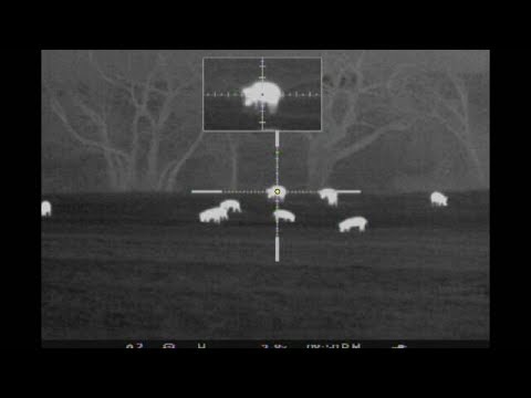

    I’ve recently also been testing “hog hunting shooting simulations” where I shoot a string of 10 as quickly as possible (returning the point of aim to target) to see if the barrel/rifle string beyond an acceptable accuracy threshold.
    All in all the Diamondback 10 shot groups stay under 2.5” and as you’ll see below a DRACOS straightjacket’ed barrel turned in a sub-MOA 10 shot continuous fire group.
    Both of these barrels get the nod on hunting day !
    Here is an example of what I try to recreate during the hog hunting simulated groups: hunting sounders of hogs will heat your barrel up fast - be ready by practicing this type of string of fire.

      And here is a video of range testing 5 and 10 shot groups
