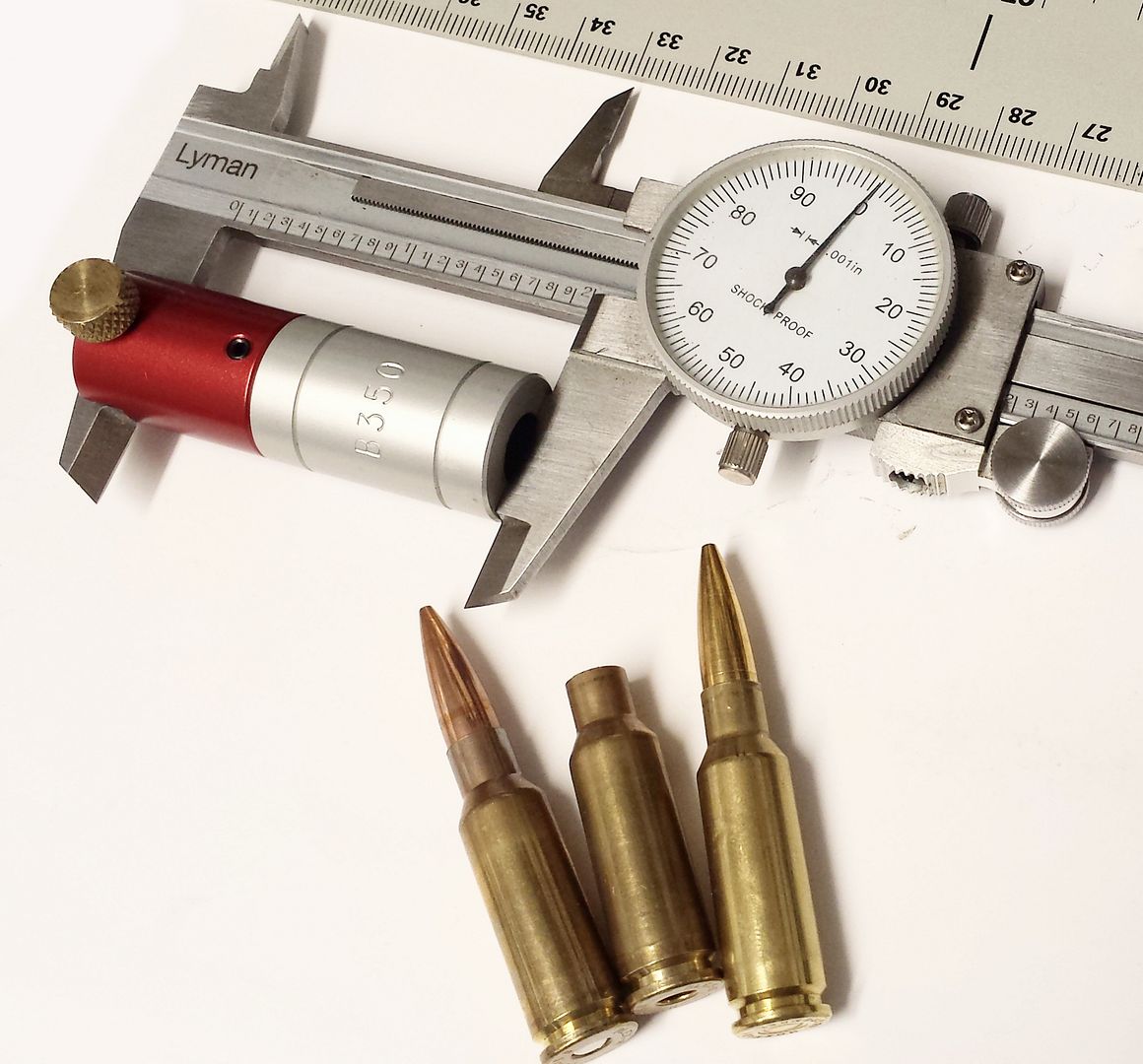

                              Get one of these (Hornady headspace comparator kit) to measure your headspace before and after firing, and set your die up based on what it will take to get consistent lock-up without moving the shoulder too much.
